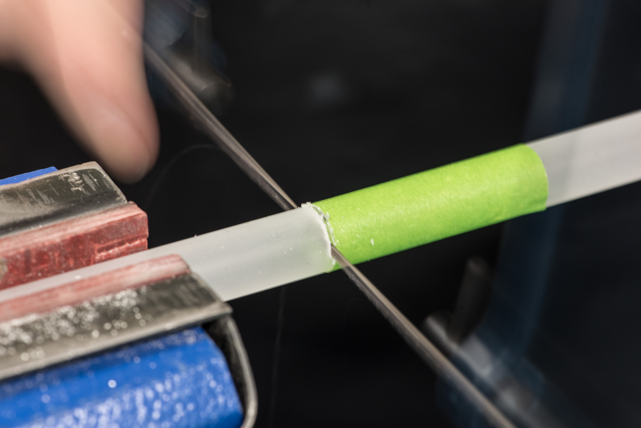

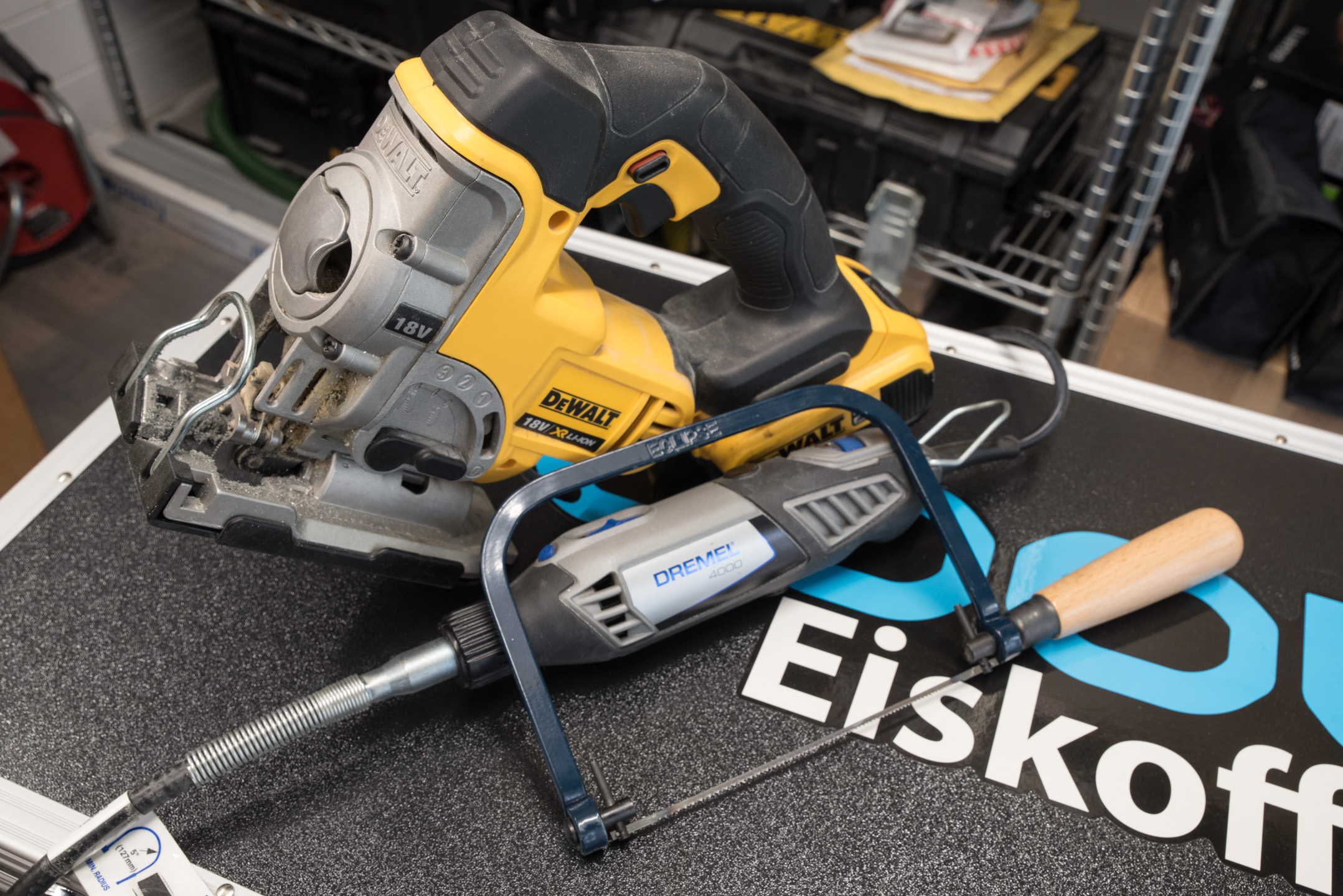

The process is largely the same albeit with a couple of crucial differences. The big consideration is that acrylic shatters, meaning you can't use a tubing cutter like the one I used for PETG. This means you have to use either a hand saw, jigsaw, or a Dremel/rotary tool. Personally, I like to use a jigsaw with a metal cutting blade, but a coping saw works very well too actually, and I used that in the demo here.
A coping saw goes through this tubing like butter and is an all round useful tool to have; I would definitely recommend one. Some bending kits come with a mitre-saw block, which can be handy for keeping the cut perpendicular. I used the tape as a guide instead, and this helps prevent any errant saw movements damaging the surface.

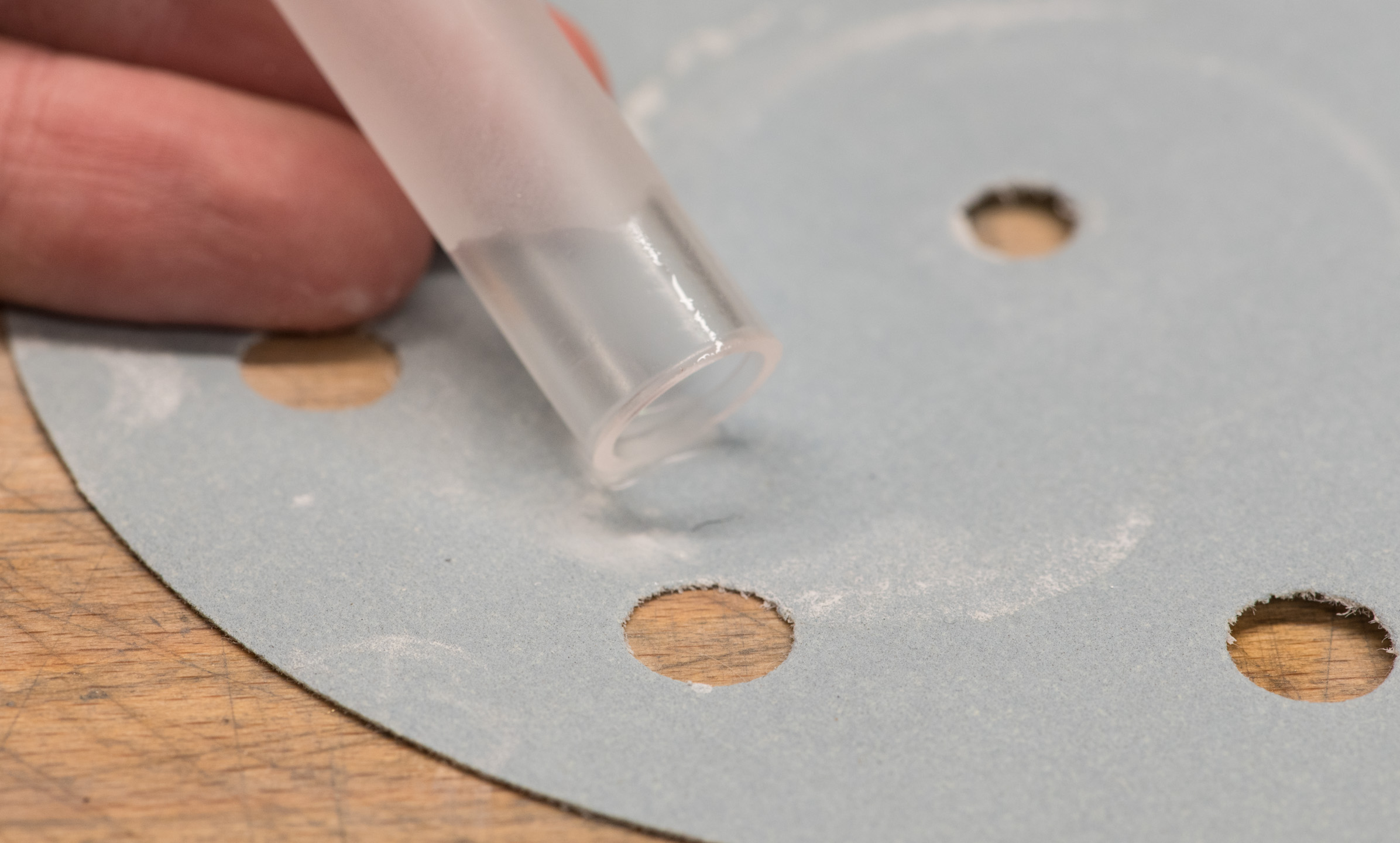

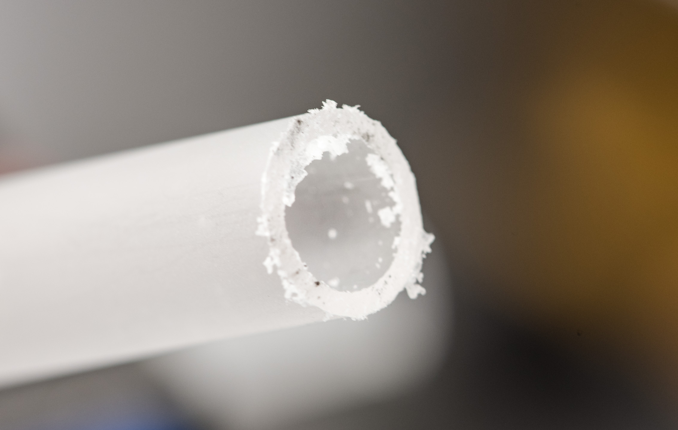

As with the PETG, the acrylic will be rough from the cutting, and since it's harder than PETG it's even more important to smooth the ends well to keep your fittings happy as Larry. Acrylic sands very easily, so I like to use this method. Simply go over the ends with 320-grit paper on top of a hard surface, then do the same around the outside to make a neat chamfer. A chamfer tool will also do this task well, but once again it can occasionally leave a rough finish. For the interior, I used a deburring tool, as the sharp blade leaves a very neat edge and it only takes seconds. The chamfer tool would work, too, as would a large countersunk bit (see the Drill Bits Toolbox for more!). You should be aiming for a neat edge like the one below.

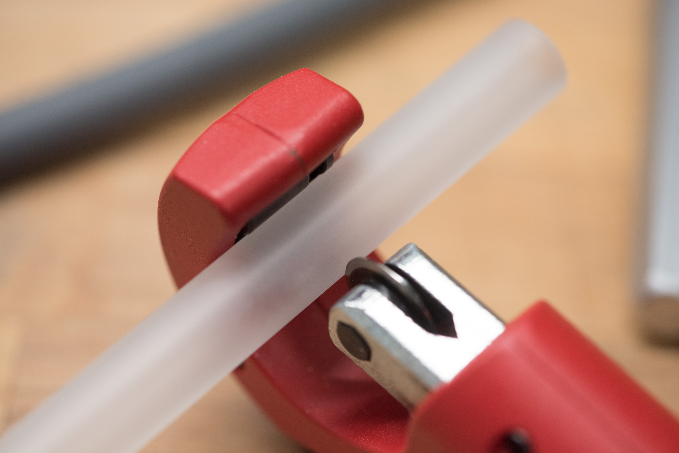

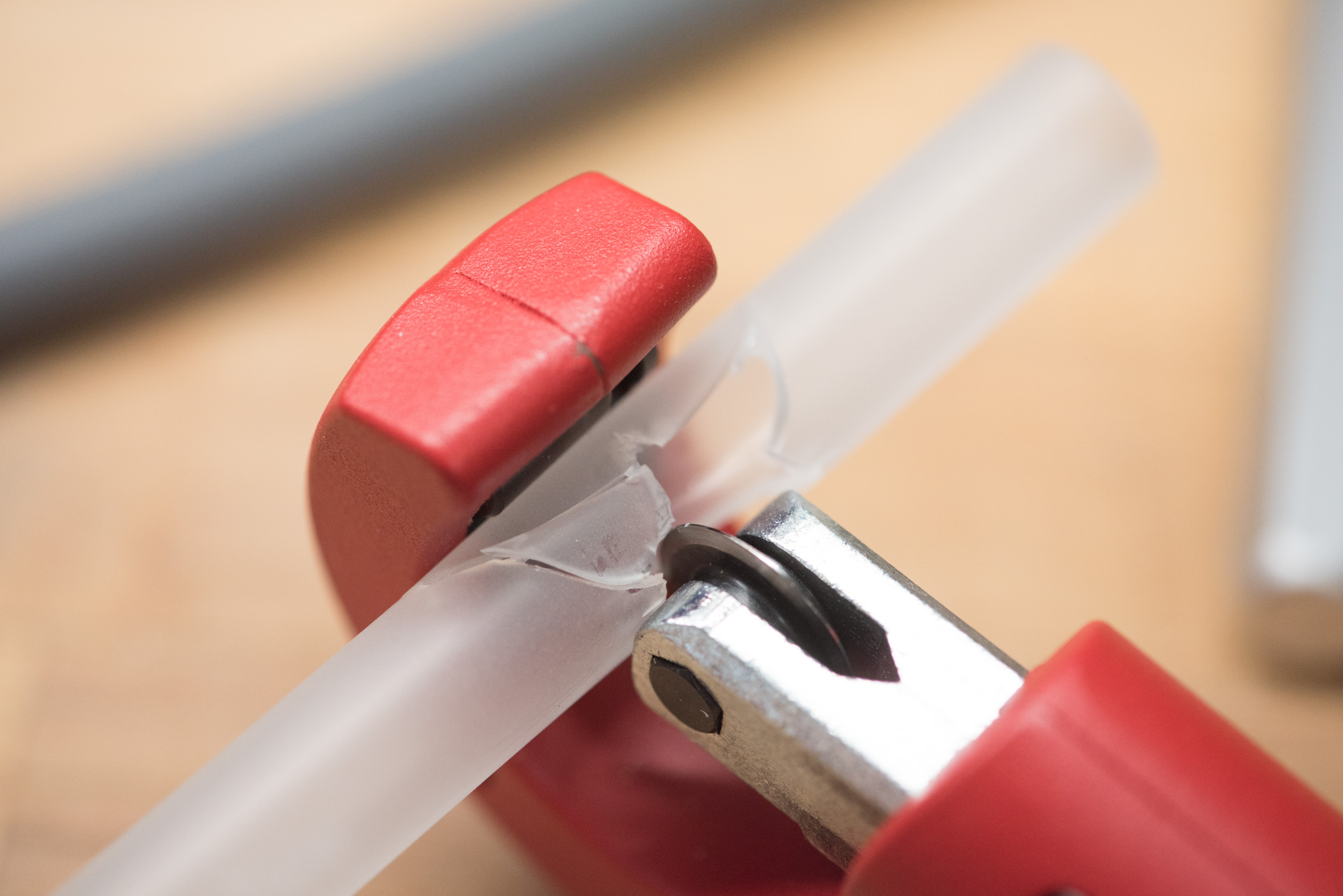

Acrylic can and will shatter if you apply enough force to it, sometimes with explosive results. I think these two photos should show quite succinctly why you shouldn't use this sort of cutter with acrylic tubing.
